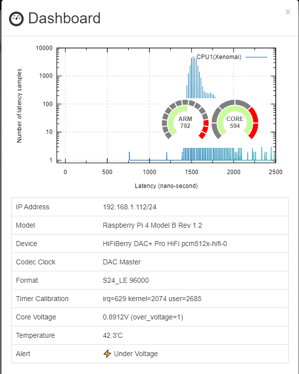

dashboard causes v1.0.6 to hang
Hello
I have a rpi4+502DAC HAT. The application works in all other respects but if I click on the "dashboard" icon, the application just has that blue bar spinning on the top, and the rest of the application freezes.
I just reboot and everything goes back to normal. It doesn't really bother me but it obviously does not work so am just reporting it.
I have sent the log via email to the support email.
Many thanks
JayM

I received the log. Thank you very much.
Please add the following two lines to /boot/config.txt.
total_mem=2048
over_voltage=1
If you are using the 4GB model, you will need to set total_mem to 3072 or lower, as there are some differences in operation in some areas.
In smpd, arm_freq, core_freq, PLL frequency, etc. have been changed, and there are cases where the voltage settings need to be adjusted.
The optimal value seems to vary depending on the individual RPi's, power supply, and HAT, but over_voltage=1 works well in all the environments we've received reports on so far.

total_mem=2048
over_voltage=1
Solved! Many many thanks Paparius-san
I'm glad it is working well.
The dashboard hang-up was recently reported and we just established a way to deal with it with the help of our members.
A low voltage is recorded in the dashboard warning column.
If low voltage or excessive temperature occurs, it will throttle for safety reasons and the arm_freq will be reduced.
The reduced processing speed can worsen the timing accuracy of the music playback process.
According to the Raspberry Pi4 datasheet, a power supply of 5V/3A is required.
Please check the power supply specifications.
