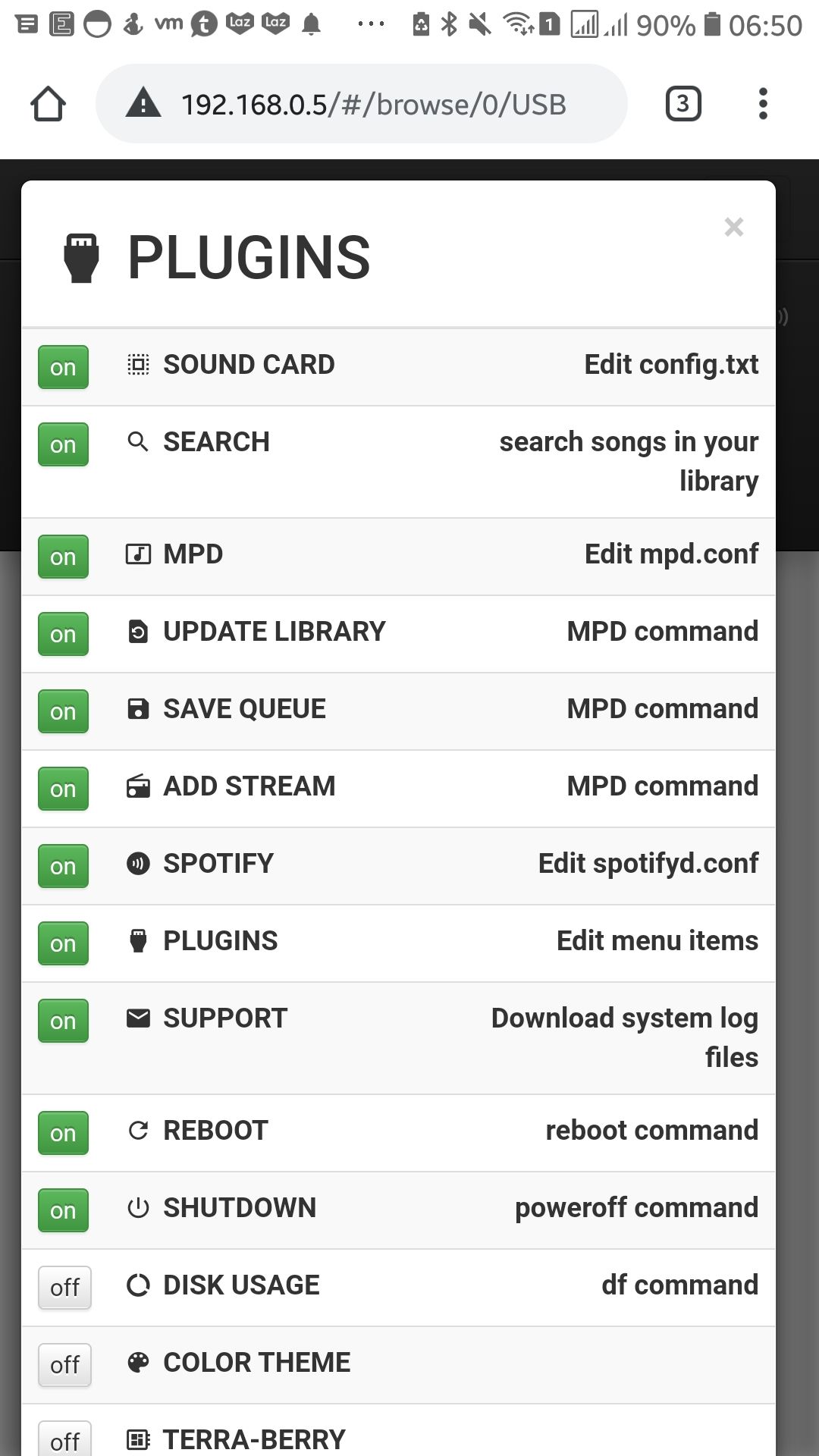

    I disabled plugin menu, so I cannot configure plugin anymore. Pls teach me how to restore default menu. Screenshot_20201221-190653_Chrome.jpg

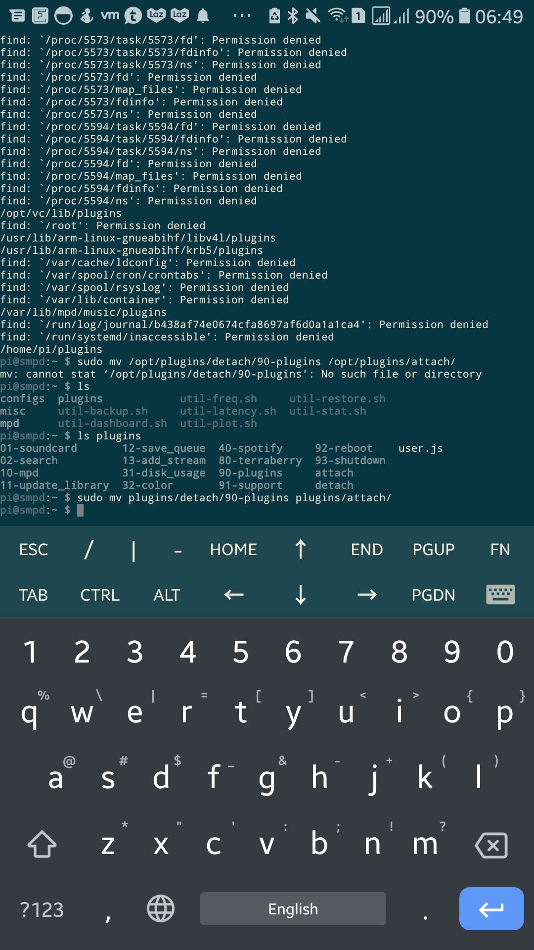

  • thank you, but in my case, i need change the path to /home/pi
    and the user is pi, not root. my plugins menu back.

  • @パパリウス -san,
    Thank you very much,
    Yes, I'm using v0.9.6.
    From your command, I can get back to default menu as below steps:
    1. Login with pi/raspberry
    2. $sudo mv plugins/detach/90-plugins plugins/attach/
