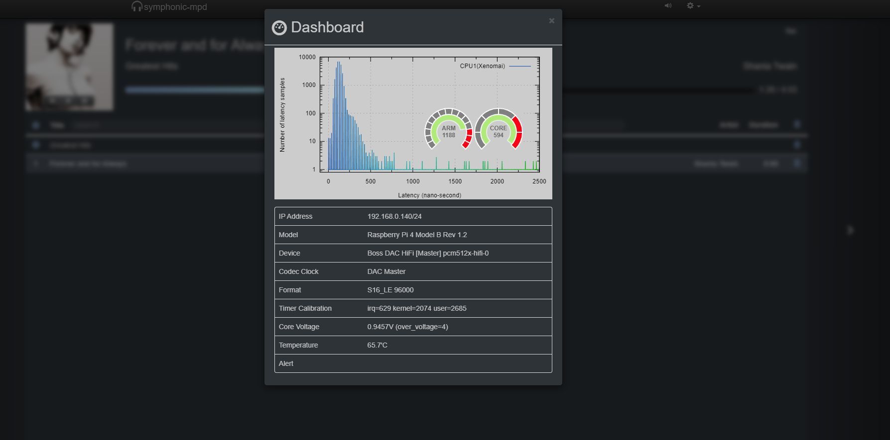

    I recently noticed 60c+ temperatures in the dashboard, is it safe to use at this temperatures? Why the temperature is so high? There are no issues in functionality everything works great, sounds wonderful too. I am using a basic heat sink on PI4, the DAC was in master mode and using a isolator between DAC and PI4 in a well ventilated case in ventilated area with lot of airflow and away for dust. Mostly Ill listen to paradise radio and my collection from NAS through ethernet, UPNP was enabled too. Adding a screenshot kindly check it guys.

    Temperature 65c+ is so high from ideal.
    Please check your environment below.

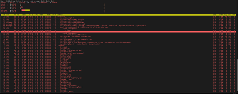

    Thanks a lot for a quick response. Nothing is using CPU load. I attached a screenshot kindly check(The screenshot was taken when playing flacCPU.png ). I sent the support log to the support address also.
  • @sowmithrichandra
    Hmm, there are no high cpu load process.

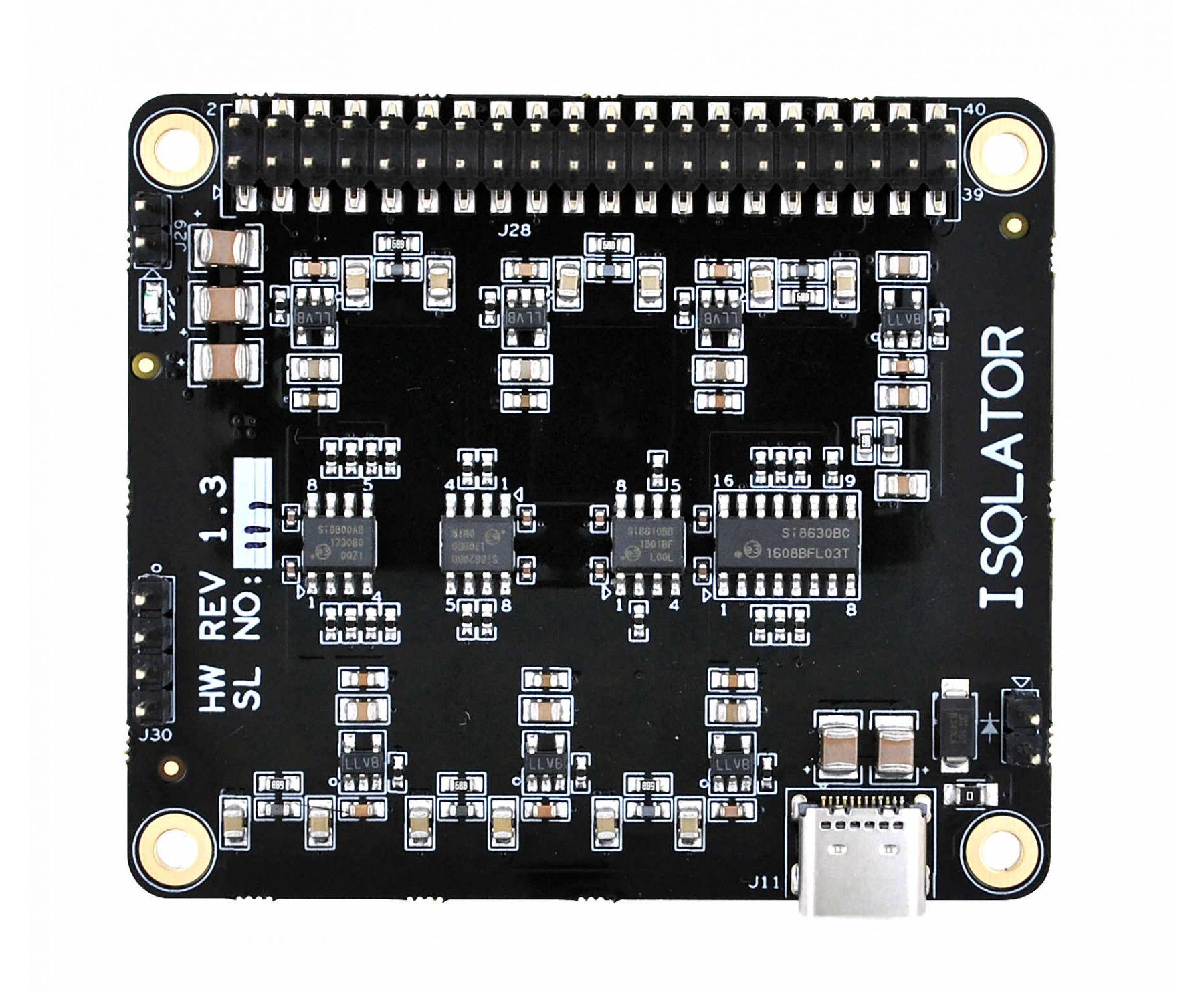

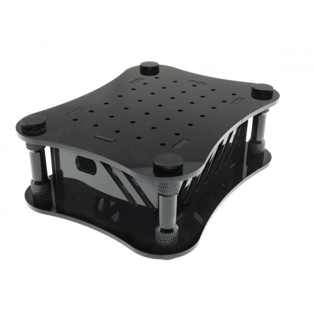

  • Thank you very much. The case I am using is acrylic case image added below. The problem is the case won't support the heat sink because of the bottom screws. To put a fan on the pi is impossible cause there will be a isolator board and on that isolator DAC board. Total of 2 boards on top of PI. Any ideas how to put a fan or any other way to cool it. Thanks in advance.allo-acrylic-case-for-allo-boss-dac-and-raspberry-pi-4-black.jpg isolator-12.jpg

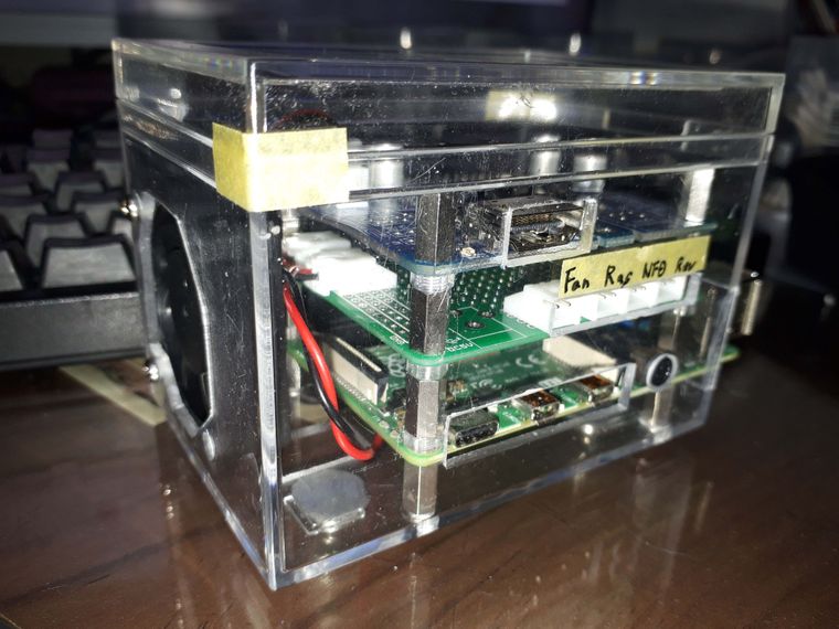

    Examples that may not be helpful
